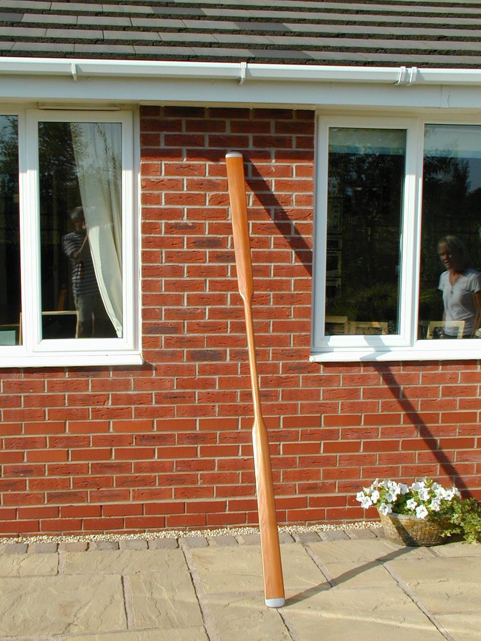

After marking up in pencil, I worked on the thickness first, keeping it as thick as possible and leaving about 1/8 of an inch extra for finishing. So at the tips the thickness was about 3/4 of an inch tapering to the 'loom' thickness of just under 2 inches. Roughing out was done with a large power saw. Then the plan view was marked out and rough sawn.

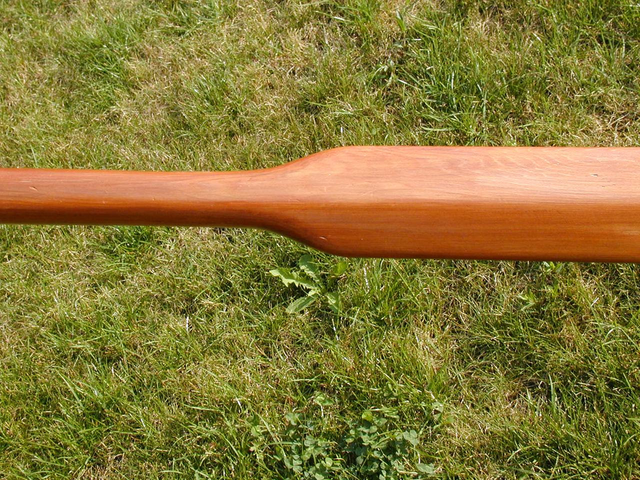

For the next stage I used a regular wood plane (well sharpened first) on the thickness. Tip: from this stage onwards be very careful with the paddle, its easy to put a dent in it by careless handling and once done you'll need to take off a whole layer to remove it. The cross sectional shape I was aiming for was a flattened ellipse at the tips that turned into a squashed diamond, then a fuller diamond as you approach the loom. I worked on the blades first leaving the loom until last. I wanted to keep as much thickness in the 'spine' as possible for strength. One manufacturer in Scotland appears to shape in flutes to minimise flutter and an overall assymetric profile that means you can only use the paddle one way round but I wasnt going to attempt this. For the shoulders around the loom area I used a surform with a convex blade. Remember you'll need to leave at least a millimetre for sanding.
The plan view shaping involved much less work with some careful shaping around the shoulders. Finally the loom was shaped. I didn't go to great lengths in trying to achieve a perfect oval, again I kept as much thickness as was comfortable with a bias to more thickness in the plane of the pull if you get what I mean.

The final stage was to apply Danish oil. This is readily obtainable from well known DIY stores. Its put on with a cloth in several layers. I put on as much as I could on the first layer without causing any excess. Three layers were applied with a days drying inbetween each coat. Finally I took off the sheen and any stickiness with some 00 grade steel wool. The finished weight is around 1200 grams.
