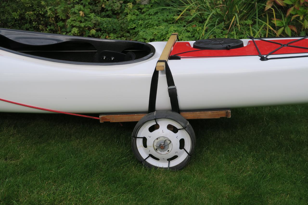

The assembly consists of two wooden side frames, an axle, two wheels, an anti roll bar and a towing handle. It attaches to the kayak by ropes and straps.

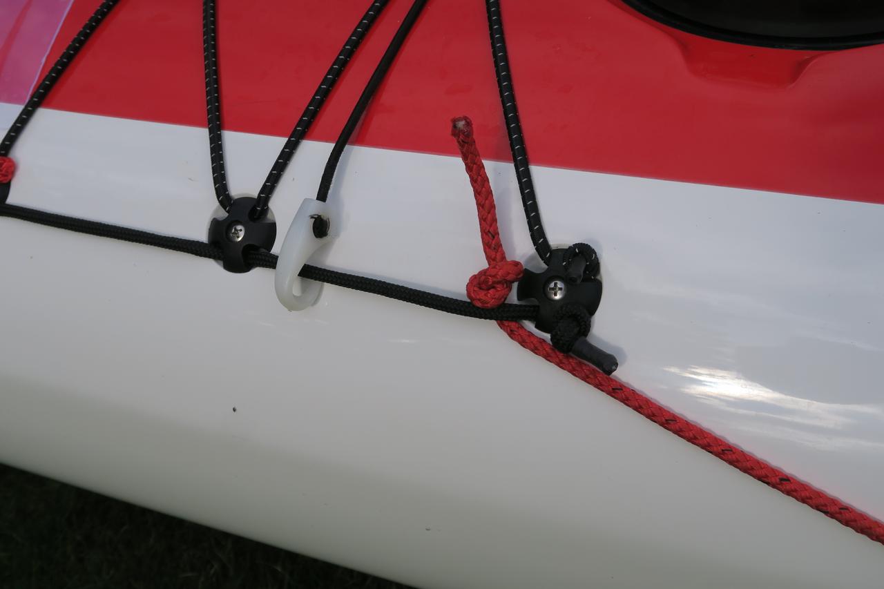

- The ropes tuck under the deck lines (overhand knot) and prevent the trolley from 'yawing' when one wheel hits a rock
- The side frames together with the axle form a solid unit

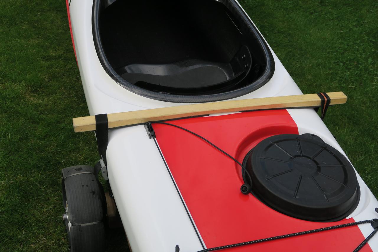

- The anti roll bar on the deck is strapped to each frame. This holds the trolley tight to the kayak and prevents the outfit from rolling when pulling over uneven ground

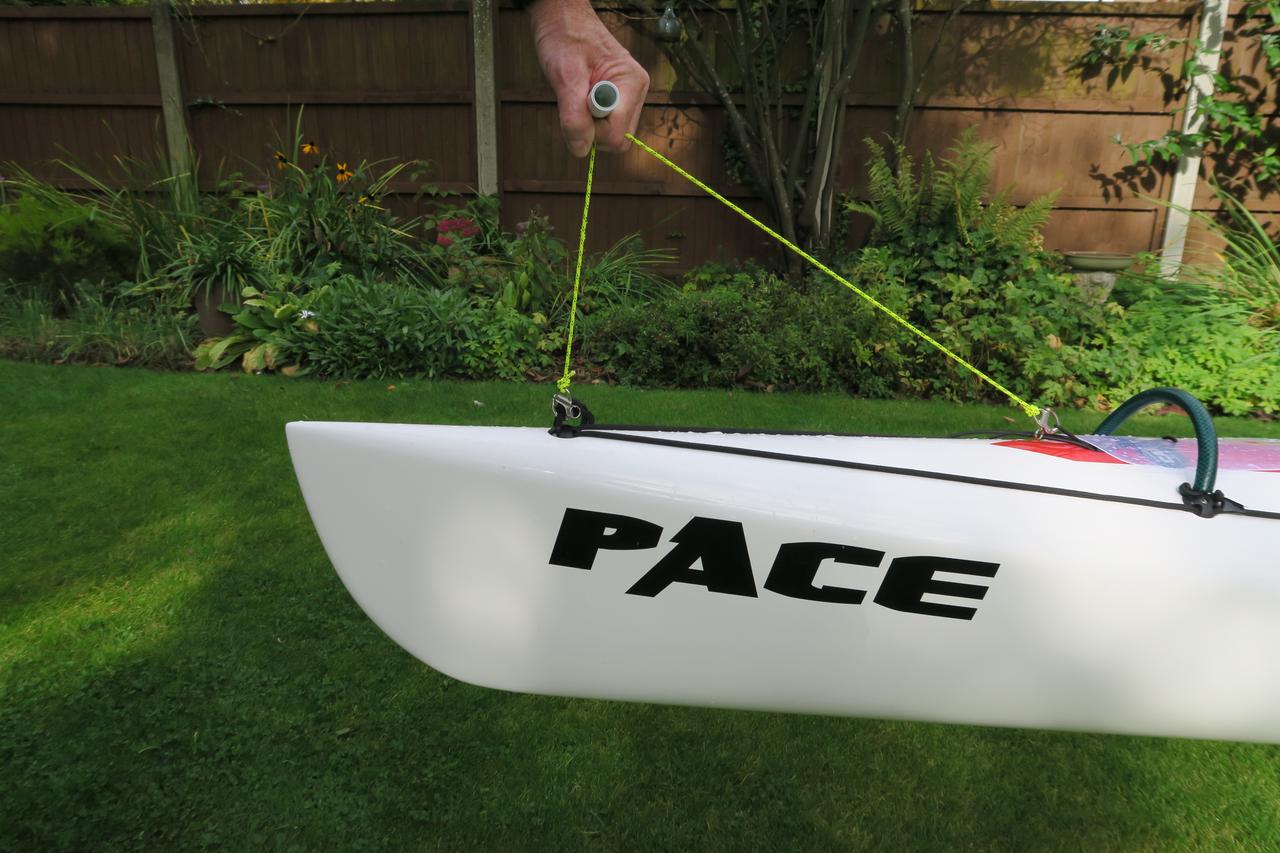

- As the kayak is relatively low to the ground, the towing handle positions the kayak parallel to the ground for a comfortable towing experience

Each frame part is made from softwood 40mm x 30mm section x 500mm long. The main length of the frame is planed to an angle to conform approximately to the cross sectional shape of the kayak. A block of 40mm x 30mm is attached under the middle to give a bit of height. A piece of 70mm x 45mm section, 80mm long is at the bottom and is drilled to take the axle. Two long woodscrews hold the 3 pieces together. The axle passes through the bottom piece; this gives the whole structure rigidity. On the top of the frame is some sticky backed dense foam from the kayak shop often used to line seats. The wood is finished in Danish oil.
