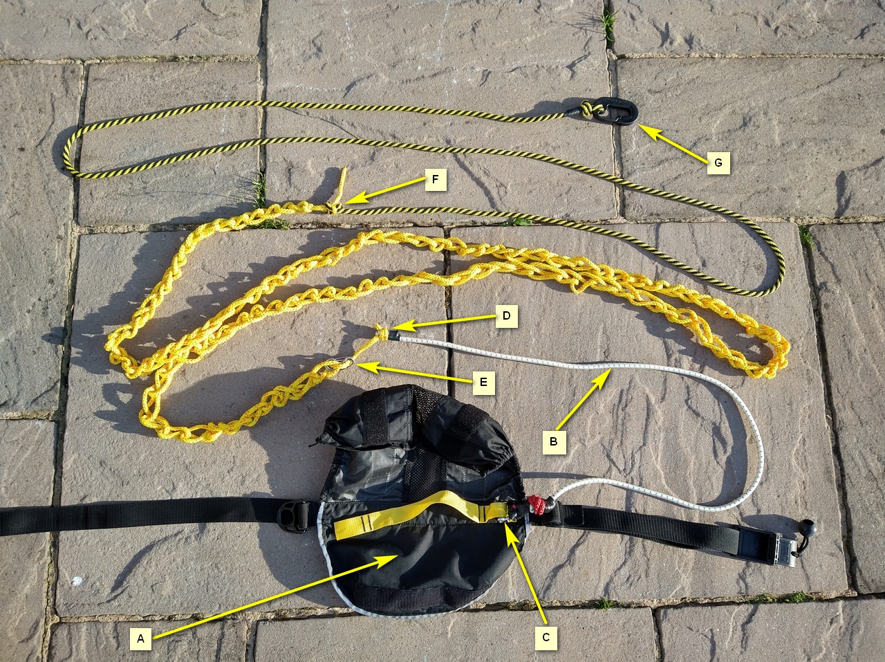

Time for a new towline; I've chosen the North Water Dynamic Pro especially for its low profile when packed. The North Water can be worn at the front (attached loosely) to help rolling as I usually surface over the back deck. However, I've made some significant changes to improve the product (IMHO). Note the carabiner clipped into a holding ring ready for deployment.
Unpacked
  1. Rather than being being a fixed shape bag or box, the towline container is a pouch that unravels.
  2. The connection between the 'tow-er' (person doing the towing) and the 'tow-ee' (person being towed) can be likened to the connection between a car and the road, ie the suspension. Do you want a 'bone shaking' or a 'comfort' ride ? I've replaced the NW shockcord loops (only about 20cm long - very little 'give') by a metre of 8mm shockcord. This gives a far more forgiving towing experience to minimise the chances of injury to the 'tow-er'. One can attach the line and paddle off at speed with no worries of a sudden jolt and likewise in big seas towing when the line is likely to pull tight suddenly.
  3. The shockcord is attached by a fisherman's knot to a short piece of cord then to a 'D' ring to provide a clean pull on the NW webbing.
  4. The main towline is attached to the shockcord by a fisherman's knot.
  5. The line is shortened by daisy chaining with a quick release to give an overall length of about 6 metres. At full length the towline is about 15 metres.
  6. The quick release knot for the 'tow-ee' (Simple Simon Over with drawloop).
  7. The carabiner.
The carabiner is plastic so there is no need for a float as it'll only sink by centimetres. If the 'tow-ee' wishes to free the towline, the 'tow-er' needs to stop paddling and the 'tow-ee' can overtake the line to reach the quick release.
